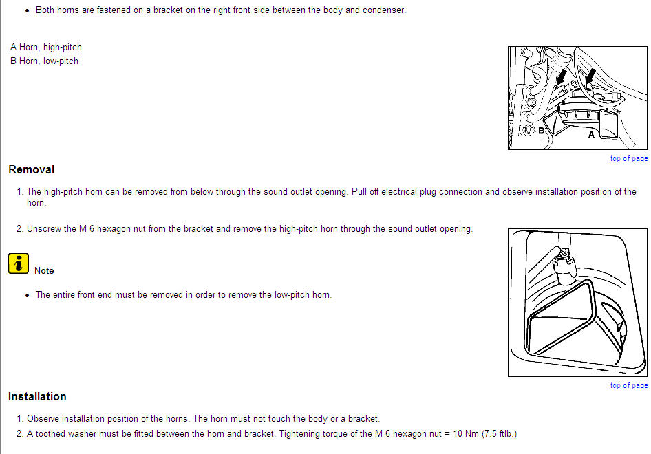

Are both horns working (high and low pitch)? The high pitch one can be changed by getting to it through the sound outlet opening, but you have to take off the front PU to get at the low pitch one. If your fault is intermittent, as you describe, it sounds to me like a bad connection or contact somewhere, or as Glyn suggests, a poor earth.

Hi, richard thanks for the thumnails, will check them out, as regards to my reserviour, mine has an opening for the pipe the same as my wifes, but no pipe, would of thought that the end would have been capped if it was a blank, the car have been working ok since i have had it though. thanks again,
