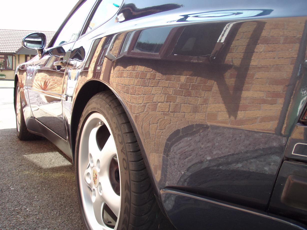

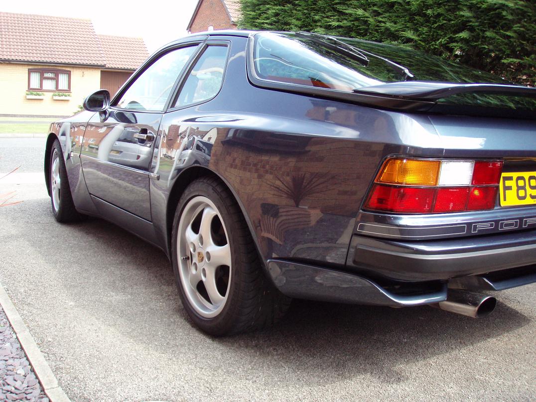

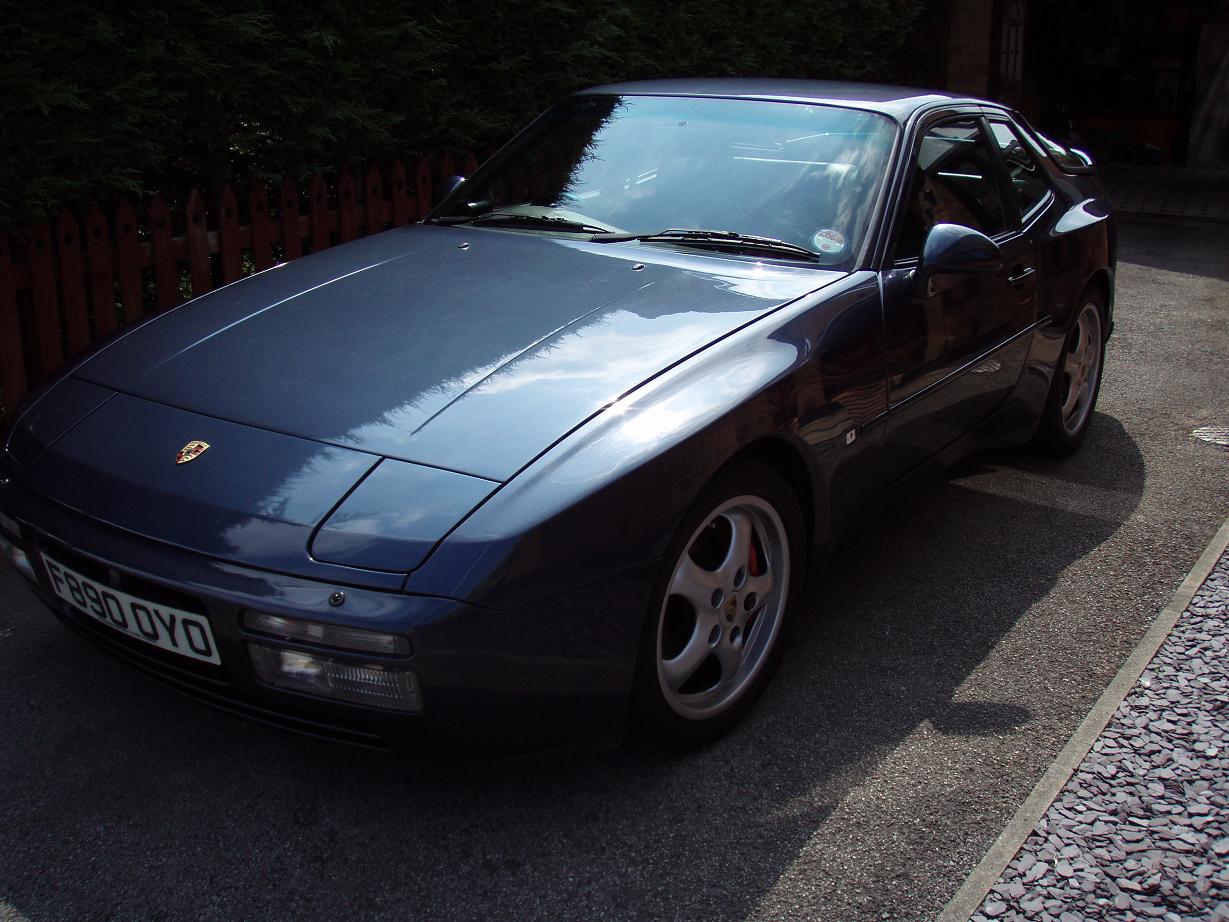

First time Claying, body like Glass!!!!
Lemon
Well I have Zymoled the car etc many times before, but this is the first time I have clayed the whole thing and then Zymoled it.
All I can say is WOW [:D]
Paintwork feels like glass.
Que a few pictures [:D]

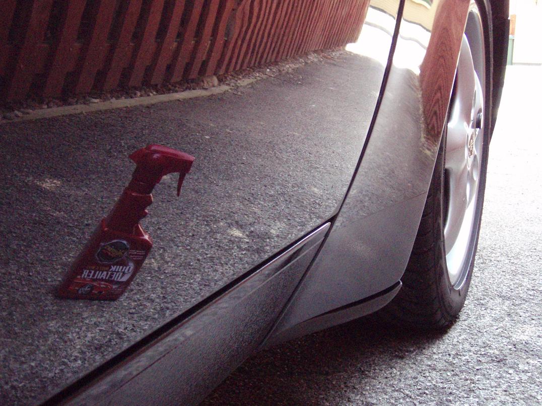

Also in the quick clay kit is a spray bottle to lubricate the bodywork.
I simply sprayed a section of body then with the clay in the tips of my fingers rubbed up and down the panel 3 to 4 times in straight lines, then changed direction 90 degrees to do the same 3 to 4 times across the same panel.

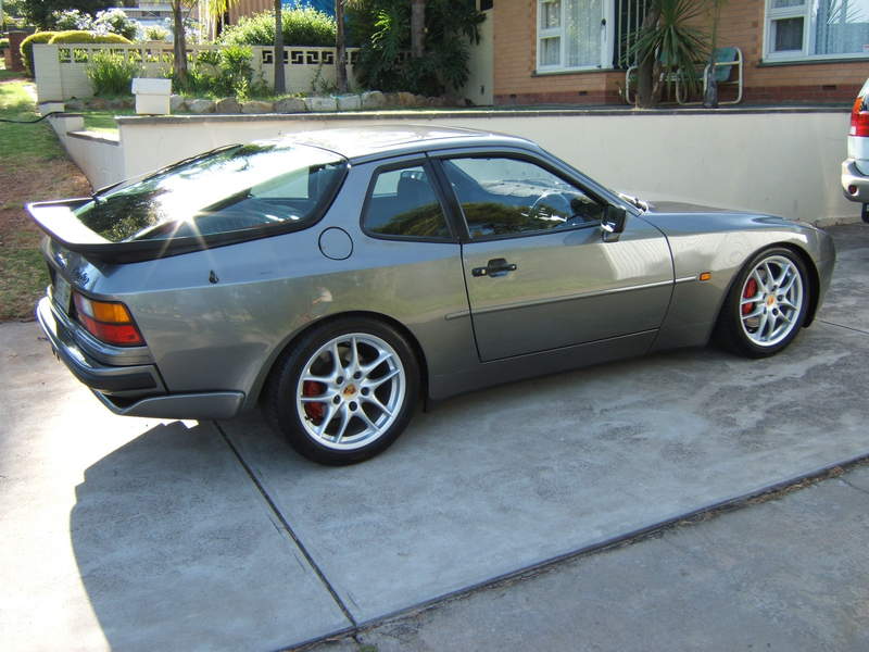

By coincidence I found a picture of my car when owned by the P.O.
Looks like he might have done it just before this picture which would only be about 3 years ago. Be nice to bring the car back up to that standard. Looks brand new.
OOOh nice, lovely colour (jealous) [&:]
