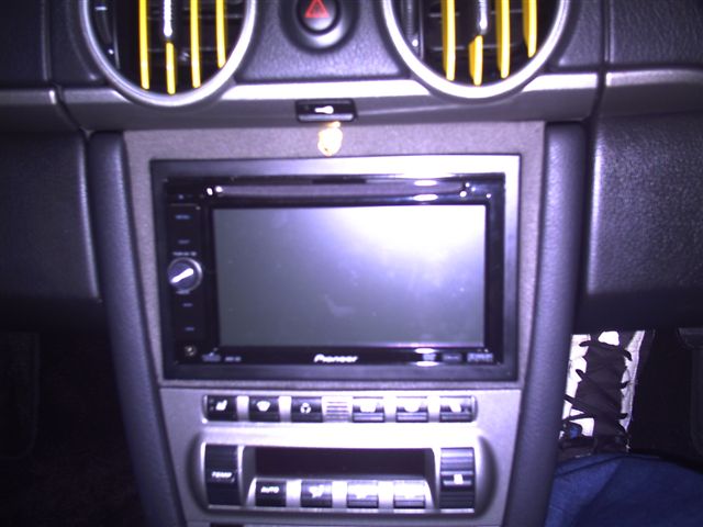

i have fitted the d 3 in and it is now up and running, here are some problems i found and how to get round them.
1. unit would not fit into dash had to make a cover/adaptor plate out of metal,to take up the space covered in foam to look better(see picture)(found out later a adaptor kit is out at £300 from japan)
2. because the porsche cd is can bus fed, to switch it on, you cannot use these wires to power it up ,you need to run a wire from fuse c-6 as a switch on ignition feed, you can use earth and constant live from porsche plug. (a can bus adaptor is out at £200)
3.a speed sensor wire needs to be put in pin 46 on abs module(white wire brown stripe).
4.illumination lead tap on to live side of dash/vent lights
5. reverse lead on rear tail light (black with blue stripe)
the speakers just plug in , (std lead)
6. i had trouble with bluetooth connection had to load software from jetwaremobile.com to get it to work.
7. loaded porsche logo into unit on boot up of unit
