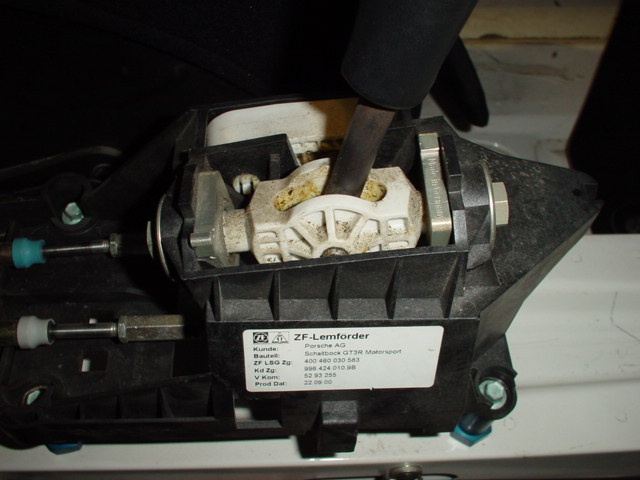

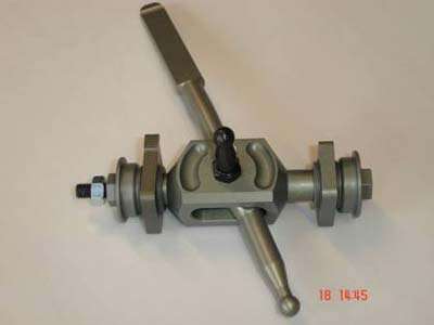

Can you provide a link for the Manthey short shift on ebay? Never seen that flavor of short shift.
But I did find this on the Manthey site.

Interesting. Similar design to this one, but this one retains the stock shift lever.
Never seen the Manthey version in the US.

Dean,
The Manthey SSK is not of the same quality as the el cheapo £50 item you bought. Andy Fearns was the eBay seller, a knowledgeable chap - hence the min reserve on the item.
I have the Manthey SSK and it is a fabulously well engineered piece of billet ally which eliminates all the freeplay in the gearchange and also rids the weak plastic components Porsche used on the original gearshift as a way of cutting costs [:mad:]. I have seen what happens when the plastic disintegrates when the car is on the move... to potentially disastrous consequences [:mad:].
The Manthey SSK is far better than the B&M unit that reduces the throw by too great a margin (B&M is -35% IIRC, whereas the Manthey SSK is -22%). Imho.
If anyone wants to try the Manthey SSK, they are welcome to give mine a go.
