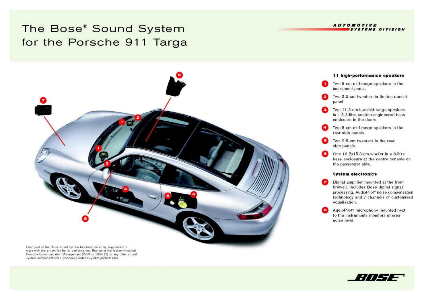

I notice that the Targa diagram in Richards post shows the sub-enclosure to be in the passenger footwell, rather than in a box behind the rear seats (like in the coupe).
I wonder if it's possible to get this sub-enclosure as a seperate part, it would be a good addition to the standard audio setup that I have, without using up valuable interior rear storage space.
