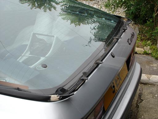

I think it's all there. As it happens I have a brand new digicam and a car outside with most of its bridge spoiler removed, so here's a pic showing how different the hatch is.
BTW Tony none of it is metal - all fibreglass, trust me, mine broke...

You would need the glass from a late S2, 951, or 968 that originally came with the bridge spoiler to make it work on your car. It will not directly bolt on to your hatch as the holes in the glass are located in different areas.
<or>
You can make that work with those pieces if you hire a competent body shop to do a custom install. This would entail removing the outside studs on the wing and moving them to a slightly different location to line up with the holes in your 944 hatch glass.
