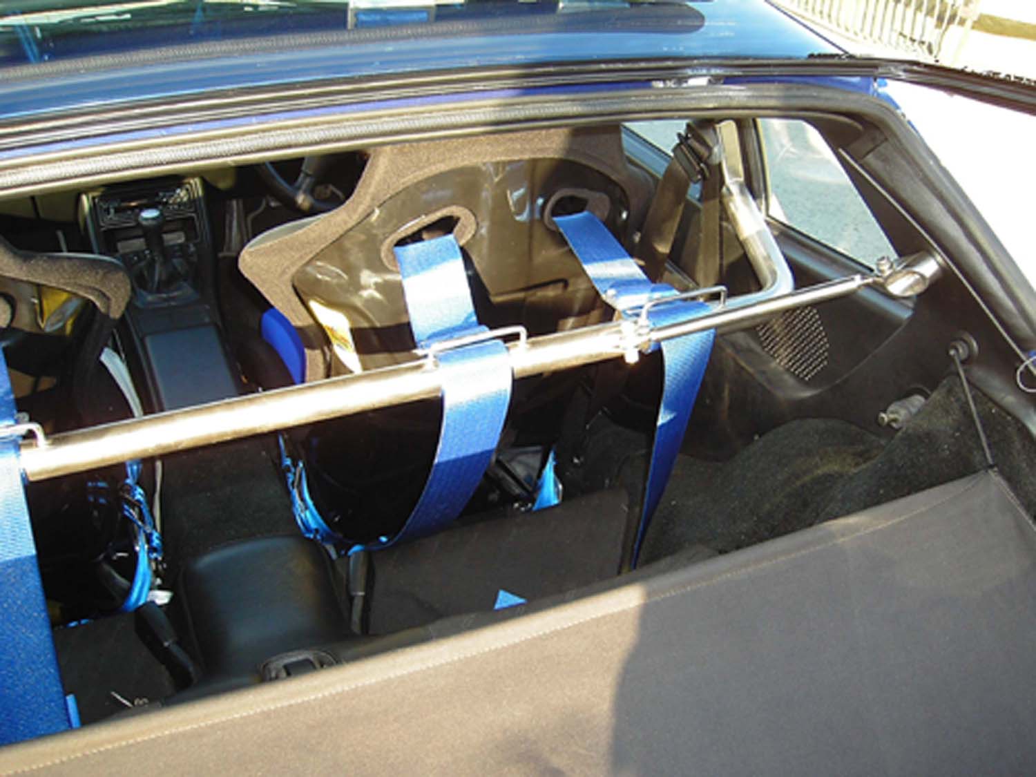

The Brey Krause one mounts to the top seatbelt mounts but kicked off backward and triangulated down to the bottom mounts as far as I remember.
Yes ive got the BK one fitted in my S2....+ NICE + neat it is too...
hopefully the pic of it is here....
That looks quite neat but if you have a look at this add from Piston heads you can see the belts traveling all the way to the rear of the car, slight snag is you cannot tell were the belts connect. I just wondered if this was a viable option as it would save on the cost of a harness bar?
I think the PH photo shows them at too steep an angle. It's amazing how many cars you see with dangerous harness fitment (in a crash they compress the spine if they angle down too much from the shoulders, which is obviously a bad thing. I think it's 15 degrees maximum (either way) rather than 45 degrees that is permissible).[FONT=verdana,geneva"] [FONT=verdana,geneva"]I happened to find a 1995 Car magazine this week where they bought a 944 2.7 (for £10,495) and had Porsche prepare it to race on the weekend for another £5k (almost). In that the harness fitted was far too low from the shoulders, probably attaching to the rear seatbelt bottom mounts I think.[FONT=verdana,geneva"] [FONT=verdana,geneva"]On the BK bar I was slightly wrong then; it triangulates to the rear upper mounts, not the front lowers. That makes a lot more sense of course.[FONT=verdana,geneva"]
