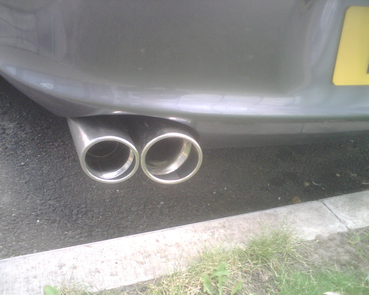

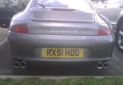

I got them yesterday form design911 for £199 plus £65 fitting (naturally all + VAT!). It took them over an hour to fit, so in my mind it was money well spent. They look the business and add and aggressive (but subtle) touch to the back end.
Dazzler
Here you go, a couple of pics. Not great quality as taken on my phone, but it gives you the idea.
