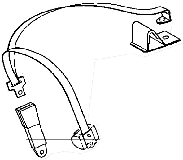

I took a look at the Porsche parts catalogue and it shows this diagram (see end of post).
So in the diagram it looks like the inertia reel is down by your lap, which just looks wrong... Everything else I've seen is like you said, under the trim over your shoulder.
Anyway I think the options I have is to either source another parcel shelf from an '87 which should have the holes in the trim, or I cut and buy a stock piece of plastic trim from a donor vehicle which would match the job. Might try the parcel shelf route first...
