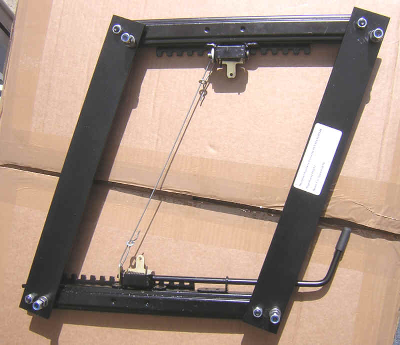

For me this gadget is invaluable, it only added a few mm to the height and means that my mechanics and myself can all drive it in comfort (I have quite short legs which doesn't help).
I suspect that this mount would fit other bucket seats but don't know for definite.
