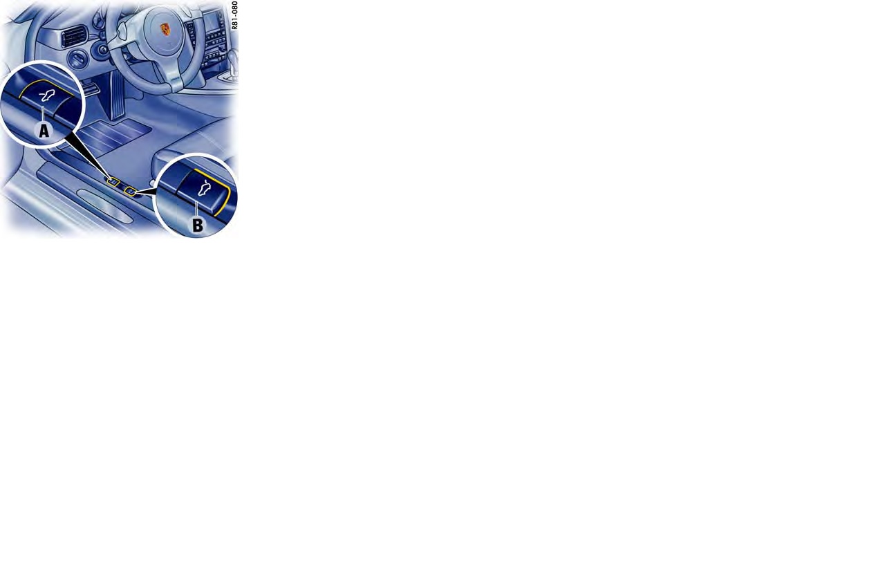

I was told there was an electric micro switch for the front lid release....which is obviously without power, until the new battery is externally connected....then it clicks...
Is there a separate "hidden" lever rather than a switch as well?
Tks.
I mean the levers that are just inside the door sill by the drivers door - one for the front lid and one for the engine compartment. Just to check - you have connected the new battery to the positive terminal that you pull out in the fuse box. Then connect the other cable to a good earth on the door frame. I think then either the key bonnet release or the aforementioned lever by the sill should open the lid
Tks, they have been tried......but a still electrically powered, unlike pre facelift 996 cables........Solenoid must be kernackered?
It's as if power isn't getting through...aaaaghhh!
