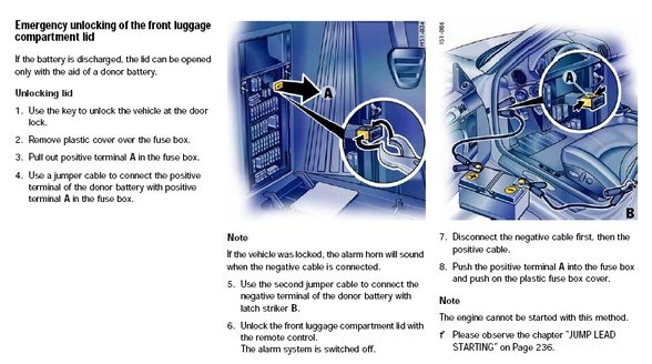

Down at the right side of the driver footwell is a fuse panel (it has the switch to raise/lower the spoiler in it)
Pull the cover off this panel, and there is a terminal that pulls out for the +ve terminal of a jump lead. Put the -ve lead on the door catch (don't do this with the engine running on the "donor" car - better still have a standalone battery). This will allow the normal switch to work to open the bonnet. Then you can jumpstart/charge as usual.
If this doesn't make sense - there are instructions in a little paper foldout inside the back of the plastic fuse panel cover.

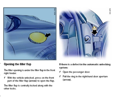

alternatively (and that is a little known trick), there is a mechanical pull in above the door mechanism of the driver' s side. A little cable that you pull. It opens the bonnet. I have had a similar issue recently.

ORIGINAL: ericsi
Er... No that is for the fuel filler flap. [:D]

You get to the battery (if it's flat) in the same way as I described above.
thanks for the help so far - popped the bonnet ok as per instructions, left the battery on charge over the weekend but it didn't take. I've had this with other cars when the battery is up down all the time so will need to get a new one....trickle charger is now in the post. One question - I couldn't for the life of me get the plastic cover to fit flush back over the battery. One corner near the screen or the other was sticking up, seemed to be feeding the tas at the base ok. Is there a knack to this or do I need to adjust any surrounding trim to get it to fit? Couldn't see anything obvious.....
