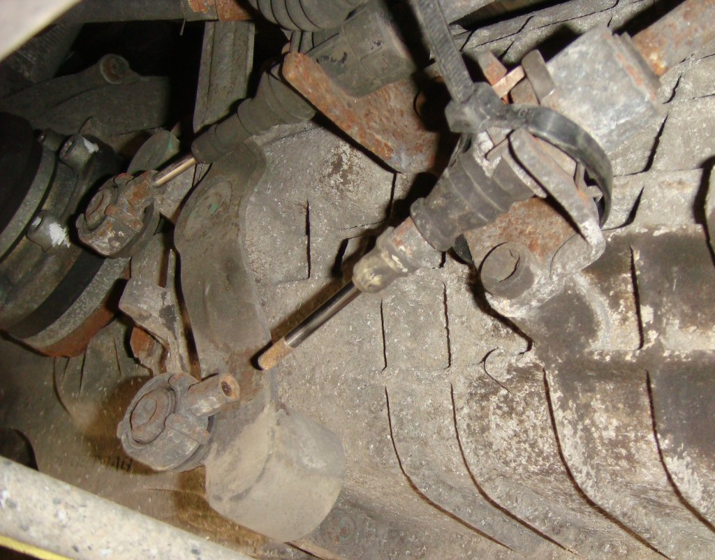

It will be most likely one of the cables at the gearbox end. If you are lucky it will be one of the clips has broken, and you can tie-wrap it back on, or it might be the cable itself:
oh no I was looking for reassurance that it was the loose greasy plastic bit that I saw lying near the bottom of the shifter lol. Is it fairly easy to spot the cables shown in the pic from below the car once raised? And which side am I looking at.
I'm not sure about the stick mechanism, as I haven't heard of one breaking before. You should be able to see if the cables are attached at the back end easily enough. Driver's side of the transmission casing. Just forward of the drive shaft, which you can see in the picture.

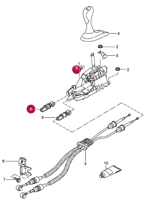

If they look OK, then you may well be correct that it is the shift lever mechanism. You can buy the fastnings where the cable goes on to the shifter, if that's what has broken.
Im hoping its at the shifter end as I saw that loose bit too. Ive done a bit of searching on a few other forums and it seems they fail at both ends pretty frequently so it coul be either. Im going to take the trim off inside the car first and investigate what that greasy bit of plastice was.

ALL FIXED! turns out the socket end (balljoint) of the cable which attaches to the bottom of the shift rod had popped off. Ive pushed it back on and tested it a bit and it seems ok. I will probably order a new part now that I know where to get the part numbers as it is probably worn and likely to reoccur. thanks for all the input
can anyone suggest how I might go about rectifying this for good as Im a bit paranoid it might do it again. I need to know if the socket for the ball on the end of the cable is actually easily renewable and if that would be of benefit. Ive seen it mentioned elsewhere that installing a short shift mech will make the problem go away completely, does anyone know if this is true and if so how does it make it go away?
