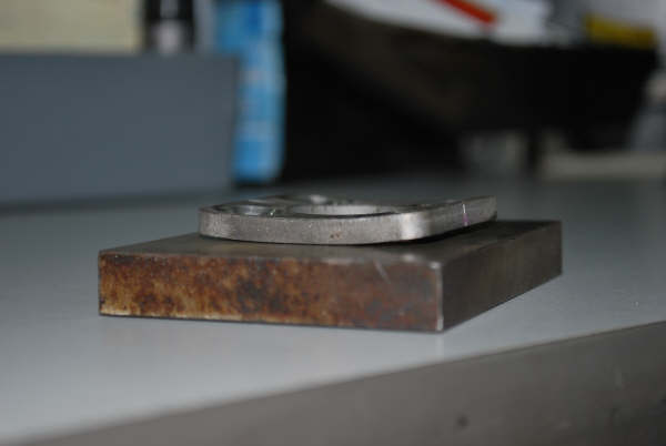

Another issue we found was the 'U' shaped surround for the eccentric bolts on the fronts were only tack welded on and they got prised apart at some stage on the track. Suddenly I had no neg camber on the front rhs while retaining -3.5 on the lhs. I can actually see it in some film and wondered why I couldn't get near some left hand apexes that day. Strange for such a good product to have some basic issues like this. Not to mention the flat piece of metal where the 4 flathead bolts go to hold the top of the strut tower where you adjust the neg camber. These pull down and deform. KW knows about this too and didn't seem too concerned. A bit disconcerting I feel.
Indeed.
Patrick, do you still use the KW3s, or have you moved on to a better damper/coil-over solution? I want to get a lower brace connecting the rear of the front a-arms, then an LSD, but I reckon the dampers will be next in the not too-distant future as an upgrade for the track car.
Tam, I had the KW 2 way race version but they have the same components generally. The top mount plate pictured should be made of a stronger metal and the design of how it's mounted could be better. I also have some Moton Clubsports waiting in the wings if I get another car together. Having remote reservoir adjustment available is a big plus.
