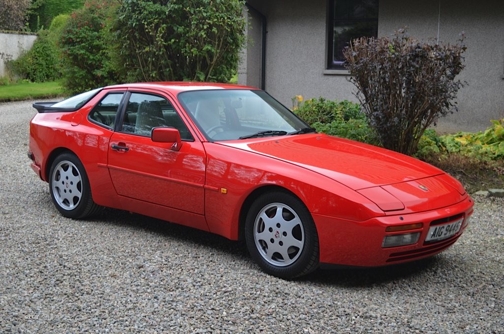

Hi just recently joined after buying an 89 S2, Loving the car so far also made a few upgrades as below
Fully adjustable coil over suspension
9 Products short shift
New front brakes/pads
Repaired digital clock
Repaired glove box lid brackets and centre storage lids cover
Upgraded stereo with Pioneer head unit and Alpine 6 x 4" speakers
I believe the wheels are from a turbo S - or Silver Rose.
The car is in excellent condition due to recent re-spray and re-built top end.
cheers
Lewis.
A warm welcome Lewis,,,,
looks a lovely car and guards red is so nice when shiny,,,
keeping it that way can be a trial,,,,,
safe and happy driving mate,,,,,jasonp
Lovely. Forged club sport (CS) wheels. Standard on turbo s and 89MY turbo and a (very) rare option on 90MY turbo's. :)
Stuart
