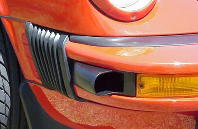

I noticed in 911 & Porsche world that the red sc had front air scoops to keep air running to the front brakes.
does anybody know where these are sold?
Yeah I wondered about those myself as I wasn't convinced by the description in the article. In Wayne Dempsey's 101 Projects for 911 book those scoops are shown somewhere, but are described as air ducts to feed the wheel arch mounted oil cooler - sounds rather more likely to me - you would only have one on the LHS (as you look from the front), I didn't notice if there was also one fitted on teh RHS. That's not to say that someone enterprising couldn't fabricate suitable ducting etc to get the air to the brake discs, but it would probably require a fair bit of jiggery pokery (technical term !)

I have seen a car with one which was to help cool the oil cooler,it replaced the small black overider next to the indicator!!

The article is misleading (I plan to email Chris Horton time permitting) as it refers to brake scoops. This is clearly cr@p as there is only a RHS scoop - indicating it is feeding cool air the oil cooler, if there is one, or loop cooler as was the case for 2.7s.

I have under A-arm ducts to the centre of the hub with hub block off plates to direct the air thru the discs (rather than spilling the air thru the hubs). To duct air from the "scoop" shown in the photos in the article to the disc is convoluted and has clearance problems. I suspect it also has air flow limitations as the scoop is in an area of low pressure. Even for oil cooling the scoop is of marginal benefit and this assumes a radiator style cooler a la 3.2 rather than the loop cooler that is more likely the case for a 2.7 (which I assume the car in question actually is) which does not really benefit from increased air flow anyway. A much simpler and concealed option is to increase the size of the notch under the bumper (or add one to a pre-3.2) and seal the area between the spoiler and the cooler so all air flow goes thru the cooler rather than spilling out beneath the cooler.

With regards to the original scoop mentioned in the first posting (as shown in 101 projects), I'm sure that getting one to fit the N/S would just be a simple case turning the O/S item upside down. The bumpers and duct look to be symetrical!! Worth a try!
Dear All,
re the oil cooler scoop for offside bumper, click on Pelican Parts link below then click on [picture] link;
http://www.pelicanparts.com/catalog/shopcart/911M/POR_911M_exteri_pg10.htm#item39
Pictures speak a thousand....
