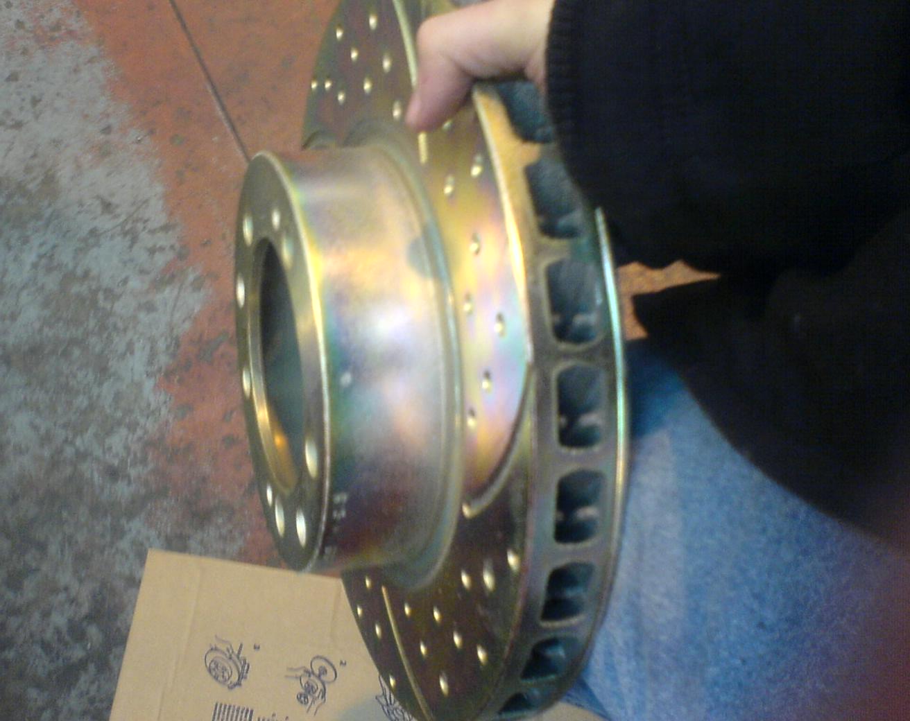

Thank you all for your kind replies . The reason I wanted to know , As you can see from the pic's they are looking very tired and could do with new bleed nipples and cross over pipes and some powder coating . I was not sure if it was worth restoring these calipers or opt for some better ones ! I was also looking to replace the standard brake disc's for a pair of cross drilled and maybe grooved disc's . Thanks best regards J.C
JC 944turboman, as a suggestion, I would stick with the standard vented disks for the front of the car. I ran some cross-drilled disks for a while whilst doing trackdays and they warped/ little cracks from the cross drilling.
IMHO, the M030 brakes with decent fluid (e.g. AP600), stainless hoses(which you already have...) and uprated pads e.g. Mintex 1155/65 should be plenty of braking even for the most enthusiastic driver on a trackday. If after 3-4 hot laps the brakes do start to fade, just have 1-2 cooling down laps
