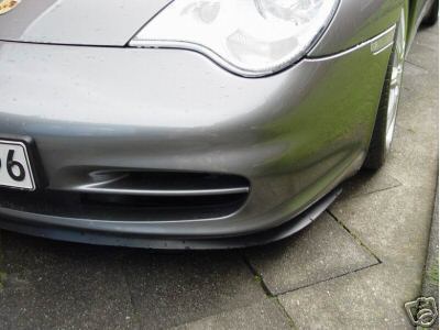

Paul did put on the "little lip" spoiler .. its a 2.5ft wide strip about 6 inch's back underneath ...
This is not straight line stability, its long sweeping curves at over 120, car starts to over steer and drift off line
Attached is a pic ...

thanks for that .. I think thats the one I could only find a picture of (shown further up in the post).
Ill get Bert to get me a quote on that..

As I have got the rear spoiler (you know you all want one! eh Paul) but no aero kit, I think I will go for the front splitter as well once I have 5 mins to put it on.
