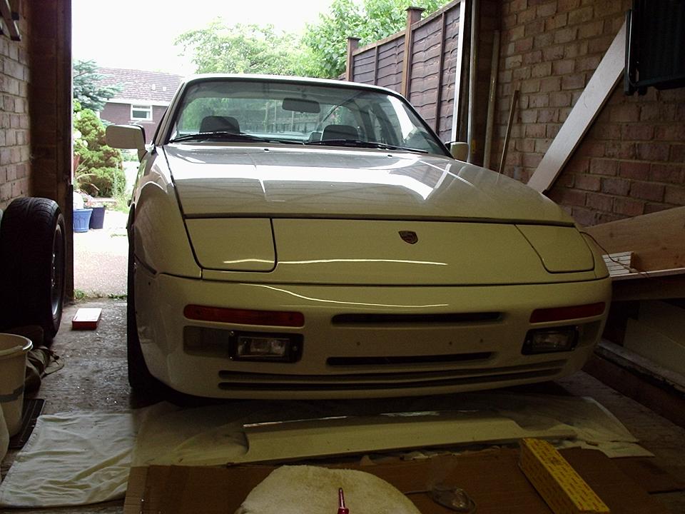

Not finished yet, but have a look......
Thanks Paul, I'm just trying to sort out the front spot lights at the moment (make them look a bit better and fill in the gaps).
Phil

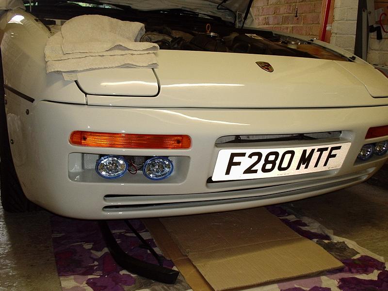

New lights/mesh all fitted now. I've put in a pair of spotlights both sides, with the outer ones converted to run side-light bulbs.
Phil
