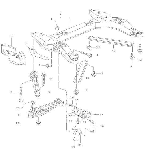

My car was with Chiswick for 4 weeks as lifting the car on the ramp revealed nothing. They then proceeded to replace suspension parts on a trial and error basis, i.e change a part, then drive it for an hour. Unfortunately as the knocking only appears after an hour of driving this method would take time. On my behalf I searched on the net and called a few indy's for the problem and everyone mentioned the links, which the OPC replaced but were not the culprit. Finally found a post on the rennlist forum where the chap had the excersise already performed, the inner tie rods were his reason. I contacted Chiswick with this info but they had earlier that same day replaced the inner tie rods and the problem was solved.
Here is the rennlist post
http://forums.rennlist.com/rennforums/showthread.php?t=367453
Sounds like it might have been the lower control arm (item 3). I checked the US list price for this item, and it seems to be about the same as the rennlist poster says. As he says, this is rare - it is usually the lower wishbone ball joint that causes a creaking, and an anti-roll bar drop link that causes a clonking. That's where I would start looking, anyway. If possible, it's best to get the car on a 4-post lift and start poking around. That way you can have the car on its wheels and bounce the suspension to try and find the noise.
