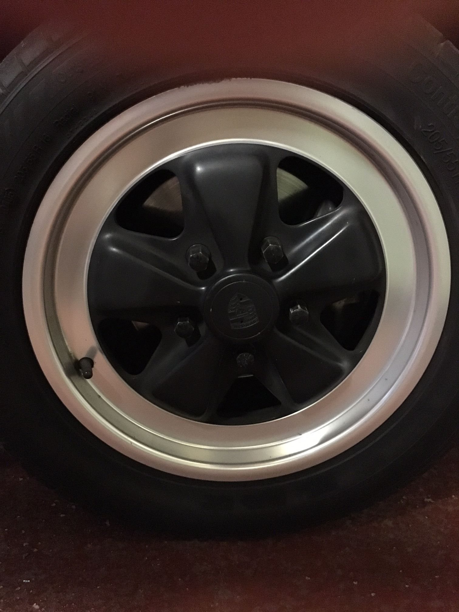

My Fuchs wheels had weights on the outside when I bought the car. I had the wheels re balanced and the tire centre fixed the weights to the inside and removed the weights from the outside of the rims. I removed the black adhesive with Autoglym tar remover and finished the wheels off with t-cut metal polish. It was hard work to carefully cleaning off the black adhesive by hand, but worth it. Here is a picture of one of the wheels now.

It is a labour of love. I used an old credit card as a scraper, so as not to damage the rim, and my finger nails. I did all the work with the wheels on the car, so a bit of back ache thrown in for good measure. If you can take the wheels off and work on a bench, that would make things easier.
