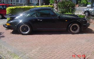

Alternatively post a picture of the car and we can all have good old debate/guess as to wheel size.

If you turned your photo avatar round a few degrees we could very quickly tell you if you had 6 and 7 or 7 and 8. It's tricky to tell the difference between an 8 and a 9 without a real close up - but that's just complicating the issue ! My guess is that you will have 6 and 8 (if you have an 8 upgrade option code !)

I must admit, your avatar does give the faintest suggestion of 7s and 8s so who knows...

6's up front and hard to tell re the rears. If they sit about an inch and a half inboard of the rear arches as per the Red car you have 7s. If they really fill the arches you have 8s. BTW, I have never seen 6/8s on anything other than 89 Carreras - on which they were standard. Quite a few European cars seem to have the 7/8x15 Fuchs option but the vast, vast majority of UK cars have 6/7x16.

Confirmed 6's & 7's, now thw search begins for a pair of reasonably priced 8's, I'm over in Germany on business in sept, maybe I'll try and source them there, in the UK & US prices are steep for a second hand pair
