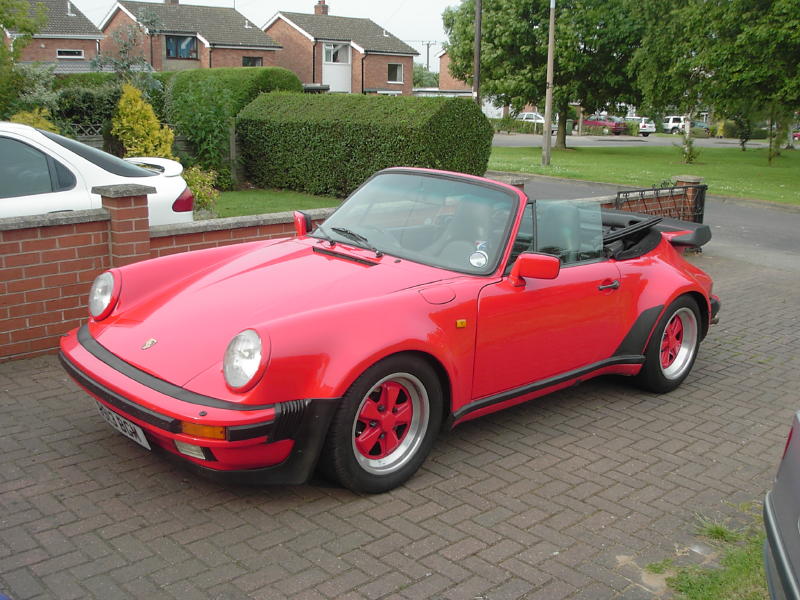

here our Red SSE Cab... came with red centres as standard, or so I beleive. As for black our coupe used to have a satin black, I still have the wheels but am Embarrassed to post pics of them... really need a referb...

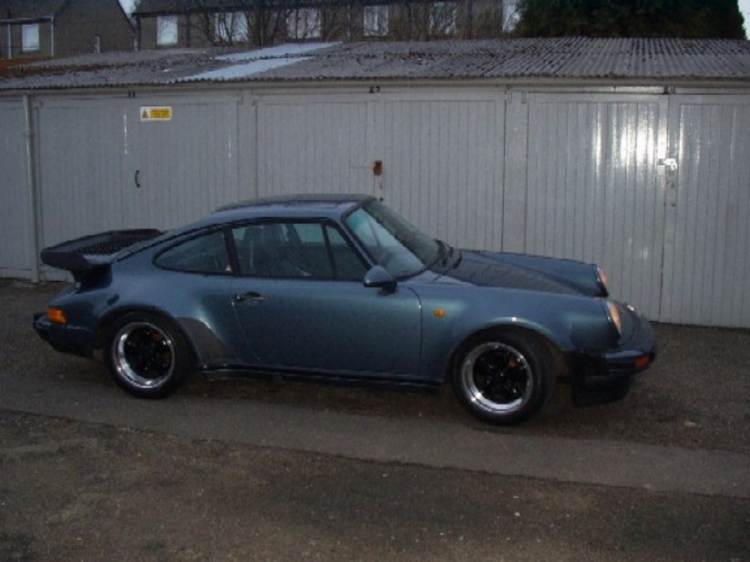

Mine are satin black with polished rims.
Look the part!
Will try and post a pic, since I have never managed to get it right yet!!
