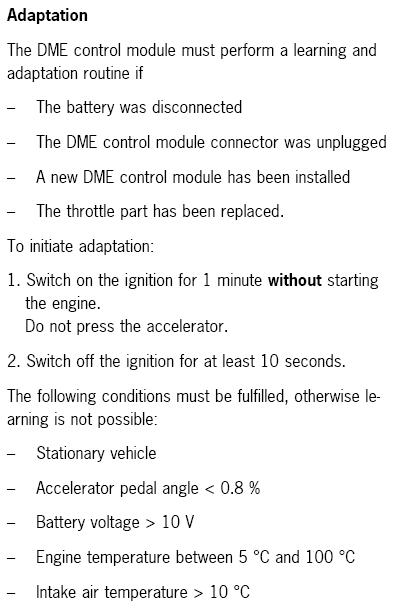

In order to do a proper comparison, it is best to reset the DME adaption first. As the car is driven, the DME will adapt fuelling and timing values in the fuel map to accommodate fuel quality and driving conditions. If you reset them before a tank of V power, and then before a tank of Regular, you can get a proper comparison.
If your car is a MY2000 or later C2, use the attached instructions. If it is MY98 or 99, then you have to disconnect the battery for a minute or two. (But make sure you know the procedure before you try it).

DME stands for Digitale Motor Elektronik, ie the engine ECU (Electronic Control Module). On a 1998 C2 the procedure for adaption would mean disconnecting the battery for a couple of minutes. If you decide to do that:
1) Make sure you have the radio code, as it will need entering when the battery is reconneced.
2) Switch on the ignition, but don't start the engine.
3) Switch off all the loads you can - Aircon, radio, interior lights, etc.
4) Leave the key in that position, and disconnect the negative terminal of the battery.
5) Wait 2-3 minutes, and reconnect.
6) Switch off the ignition.
You will probably find it will make a difference to the performance.
