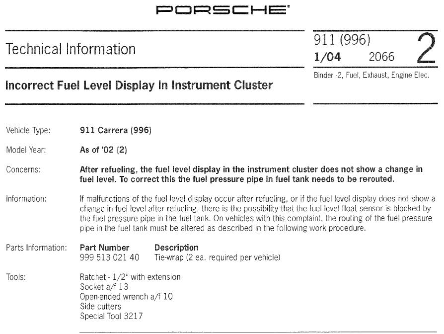

Stuart's is a C2, so it doesn't have the C4 'saddle' tank.
But it sounds like this to me:
Yep, that's exactly it! Funny how my OPC didn't recognise the problem when I explained it to them.
How about a 'how to' article, or am I being too demanding? Sounds like its a DIY proposition.
You're damned good you are. Excellent resources, well impressed.
