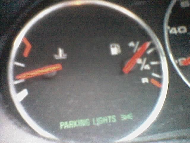

Just to make you guys jealous, here's a crap picture of mine after 25 miles, taken with my phone, hence the quality.

Mine only reads 3/4 even after £60 worth of fuel!!!!
Mine too!![8|]
Its soooo blomin annoying aint it, after puting 70l of fuel in the car you would think that it would atleast extend you the courtesy of reading full!!!!
I need to fix that it really pi55es me off....
