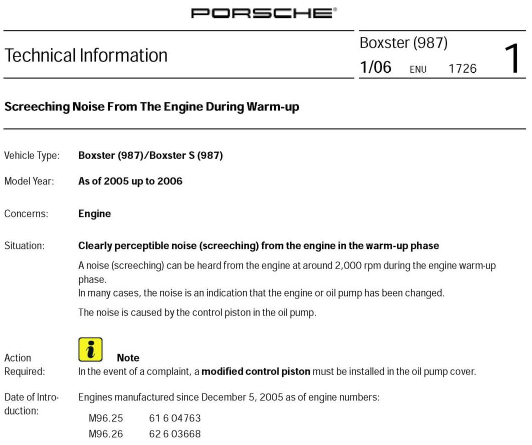

Could it be this?
so i need a modified controlled piston fitted. is this correct as mine was made oct 2005 before routine fitting???

yes - it was the modified release piston thingy. it has been changed and the car is on the way back to me. note - the wind deflector has also been changed under new recall as the seals are failing.
