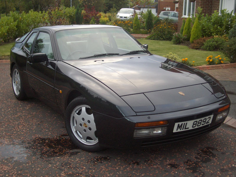

Picture below.
It's not perfect, but for a 14 year old car with 80k, it's about as good as it gets without going concours (and I would hate that as i want to use it!)
It needs a couple of bits and bobs, but has a full OPC history, and all of the bills & MOTS from the second owner on (the first owner was Porsche GB!)

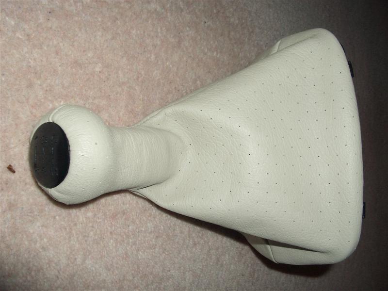

Have attached a picture of my new gear gator for anyone who's interested - a dodle to fit (if a little fiddley).

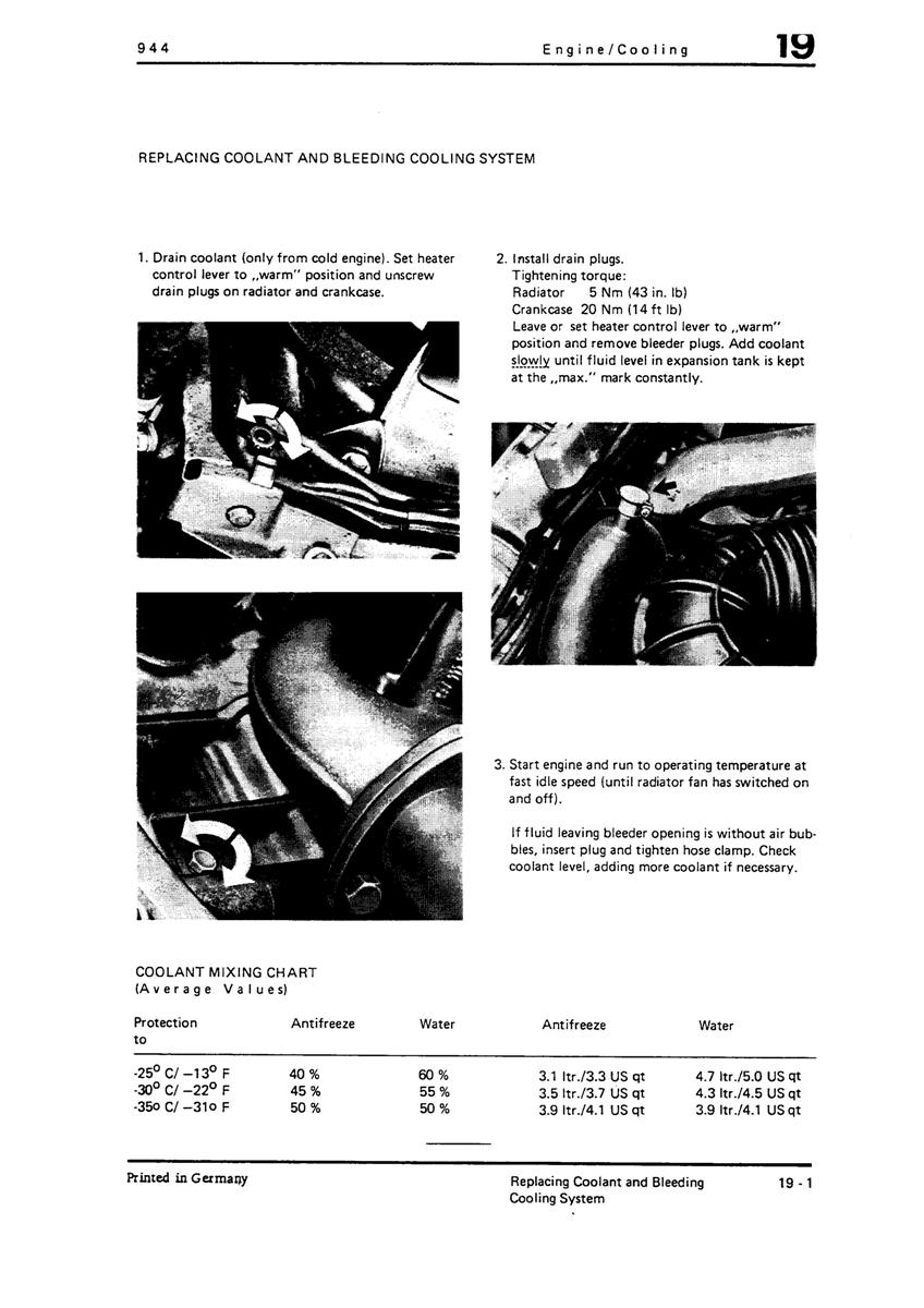

Where is the blead screw on the coolant, I must be blind i cant find it[&:].
Theres a yellow sticker near the bonnet catch thats shows a diagram of where it is, but i can't understand what the picture is showing. I bet its really obvious[:D][:D]
Errr,
Not as easy as it sounds. The workshop manual is specifically vague, and I've not take a look ,myself. The story goes (although Im sure someone will correct me!)
Up until Model year 1989, there were two bleed screws - one on the crank case, and one on the radiator (which make ssense!)
From 89 on, the crankcase bleed screw was discontinued, and moved to the water pump housing, although it says that this is for Turbo models only, so it gets a bit more confusing!!
Rather than trying to explain more (blind as I am by not actually having had a look yet!!), i've attached an image to this message, and one to the next from the workshop manual - if it makes it clear to you where the pictures are located, I would be grateful if you'd tell me, meaning I wouldn't have to hunt around [;)].
Not sure about the s2 (or that picture) on the lux it is at the front of the head on top of a coolant elbow, on the turbo it is in a similar place but on the side of the coolant elbow almost under a hard pipe (to the intercooler) and often hidden by the number 1 plug lead,
Tony
Thanks for the reply - allowing me to post he second piture!!
As I said, haven't had a look myself, but am assuming they're both at the bottom somewhere[:)][:)]
