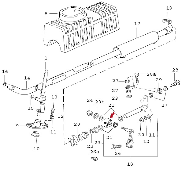

In order to eliminate the remaining slop from the gear change, I want to replace a part that is located at the transmission end. Problem is, PET doesn't appear to show a part number. I've attached a diagram with the part in question identified with an arrow.
I'm guessing that the part is a nylon/rubber block that transfers movement from the shift rod to the shift lever. I know others have replaced their's with a short-shift alternative, but I'd be happy with the standard part, after all it's lasted for 20 years.
Any idea what the part number would be?
Seems to me it's part of #18, so it may not be available by Porsche unless ordering #18.
By the way, #29 is worth being replaced too.
Thanks for the reply Thom. I suppose it could be part of #18. My confusion is/was because the part appears to be a separate entity.
Neil
Talk to Jon Mitchell, he has a guy making selector parts for him and he can supply the part you need.
