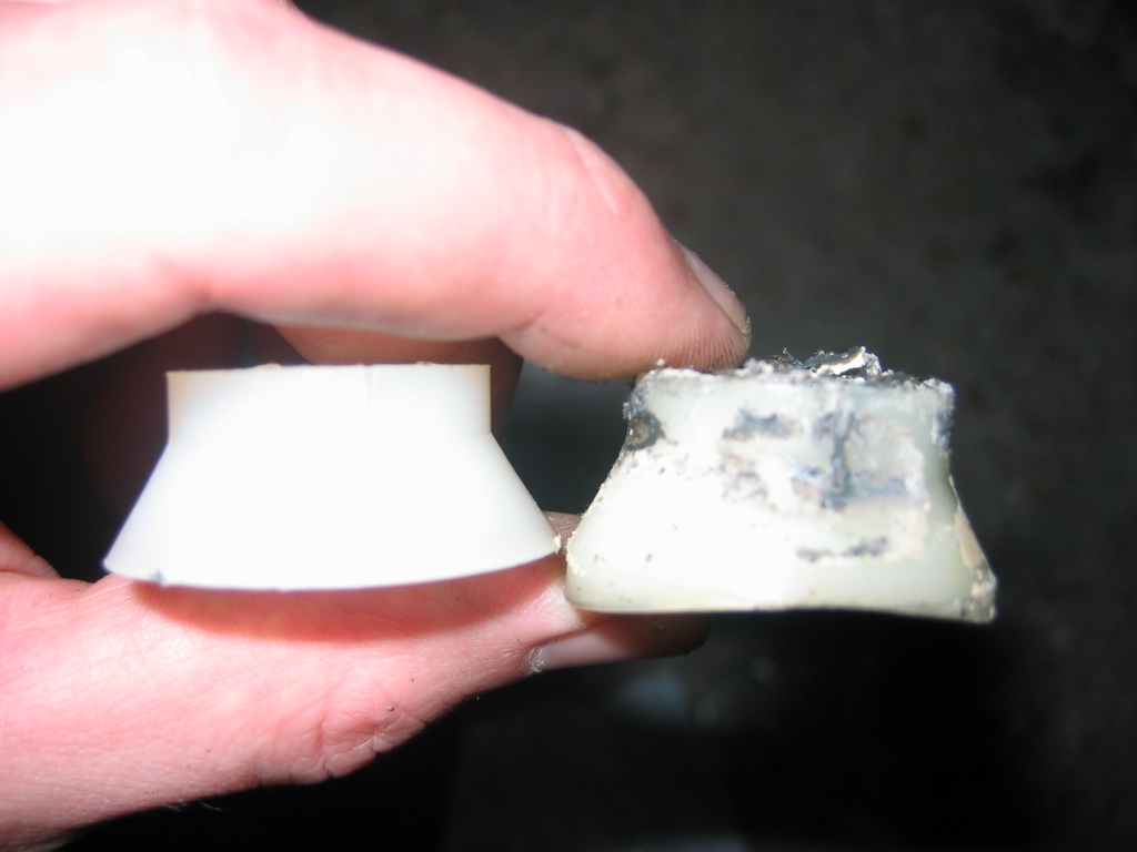

Funny that, I changed mine an hour ago.
I found myself replacing this only as the gearshift linkage itself looked as new. [:)]
New vs old (95k miles) below :
It was the gear stick end, the section below the leather- rubber cap, which is bolted to the transmission tunnel.
It has a 10mm pin that wears to a dumbell shape - Jon does an exchange, he replaces the old pin with a nice shiny stainless steel element.
The bush fits into the section that goes back to the gearbox at the back, next job to do.[sm=spanner1.gif]

It makes a huge difference to the shift - also worth replacing the lever / bush if you're doing it - there can be some looseness at that end, and the peg that connects the lever to the rod wears oval & will eventually start to rattle.
