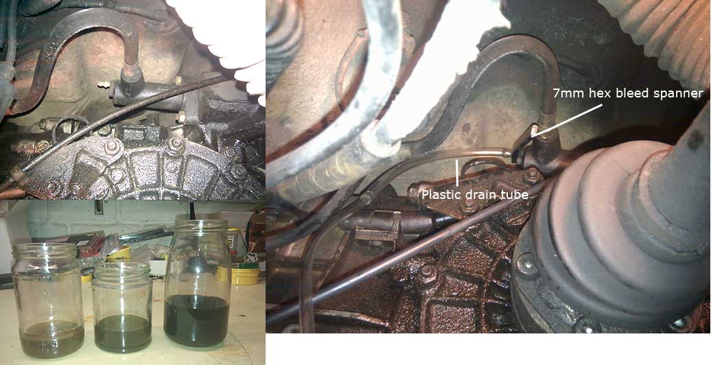

As you've mentioned elsewhere Steve, a crazy ambidextrous left hand position on your back but with a good view. Had to saw in half the double-ended spanner just to get the turn radius obstructed by that high pressure pipe into the slave cylinder. Hopefully the pic below gives an idea.
Couldn't believe the amount of black thick fluid being forced out. Swapped jars a couple of times just to see when I could expect some clear fluid to start showing - again in the pic.
