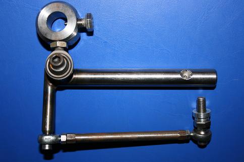

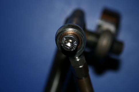

Mine from John Mitchell.
Can't vouch for it on the car as it isn't yet. Feels well made though.
I have something similar which was fabricated and fitted by the mechanic who used to own my car. It's combined with a cut-down shorter gearstick to provide a very positive gear change. Feels very different to either of the standard 944s I owned before"”much better in my opinion. I've never taken things apart to see exactly what it looks like though, so these pics are all very interesting.

RPM dont do one (that I know of) they just fitted mine for me, not sure where it came from but looks v similar to Jon Mitchell's posted here.
