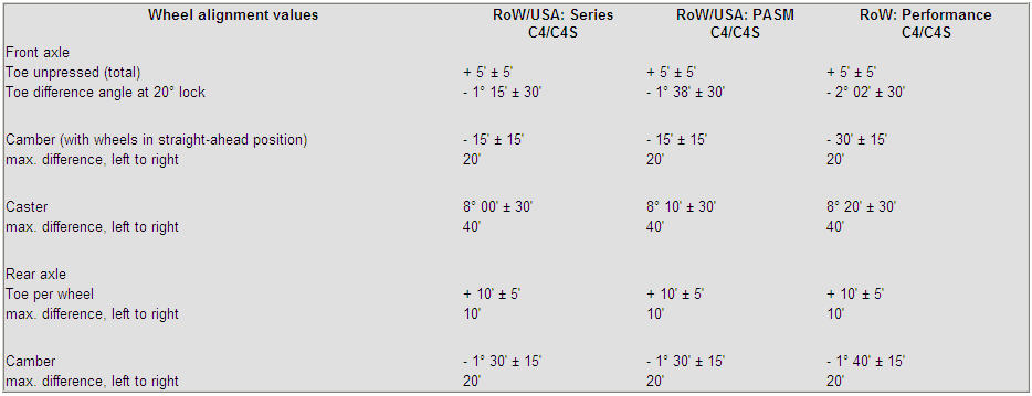

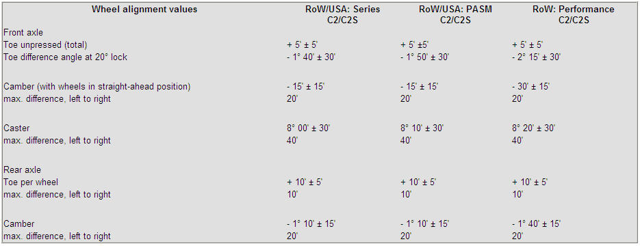

Went today to have my car 4 wheel laser aligned at a tyre specialist who I've used many times, and who set up my Cayman previously.
When he logged onto his system there were no geometry settings for the 997 of any kind [], every other Porsche was on it except the 997 [8|].
Can anyone provide me with the right settings, the car is a 2005 Carrera with PASM.
Any help greatfully received
