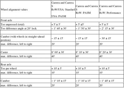

Does anyone know the stock settings for the following 997 types?
2S Sport suspension (-20mm No PASM)
GT3.1
I have found some values for C2S performance, whatever that is?
Front axle
Toe - +5' tolerance +- 5'
Camber - -30' tolerance +- 15'
Rear axle
Toe - +10' tolerance +- 5'
Camber - 1deg40' tolerance +- 15'
I think those are pretty much the standard figures for all the Carreras (and the turbo too!) Geoff

Yes Alex, just looked again and there are some variations!! Doh! All the front toes seem to be the same at +5 and rear toes at +10. The variety is in the cambers?
Come on then Alan, where are you getting that info?
From the data sheets that Chris gave me the last time I was at CG.
Blurry photo from Renntech too
