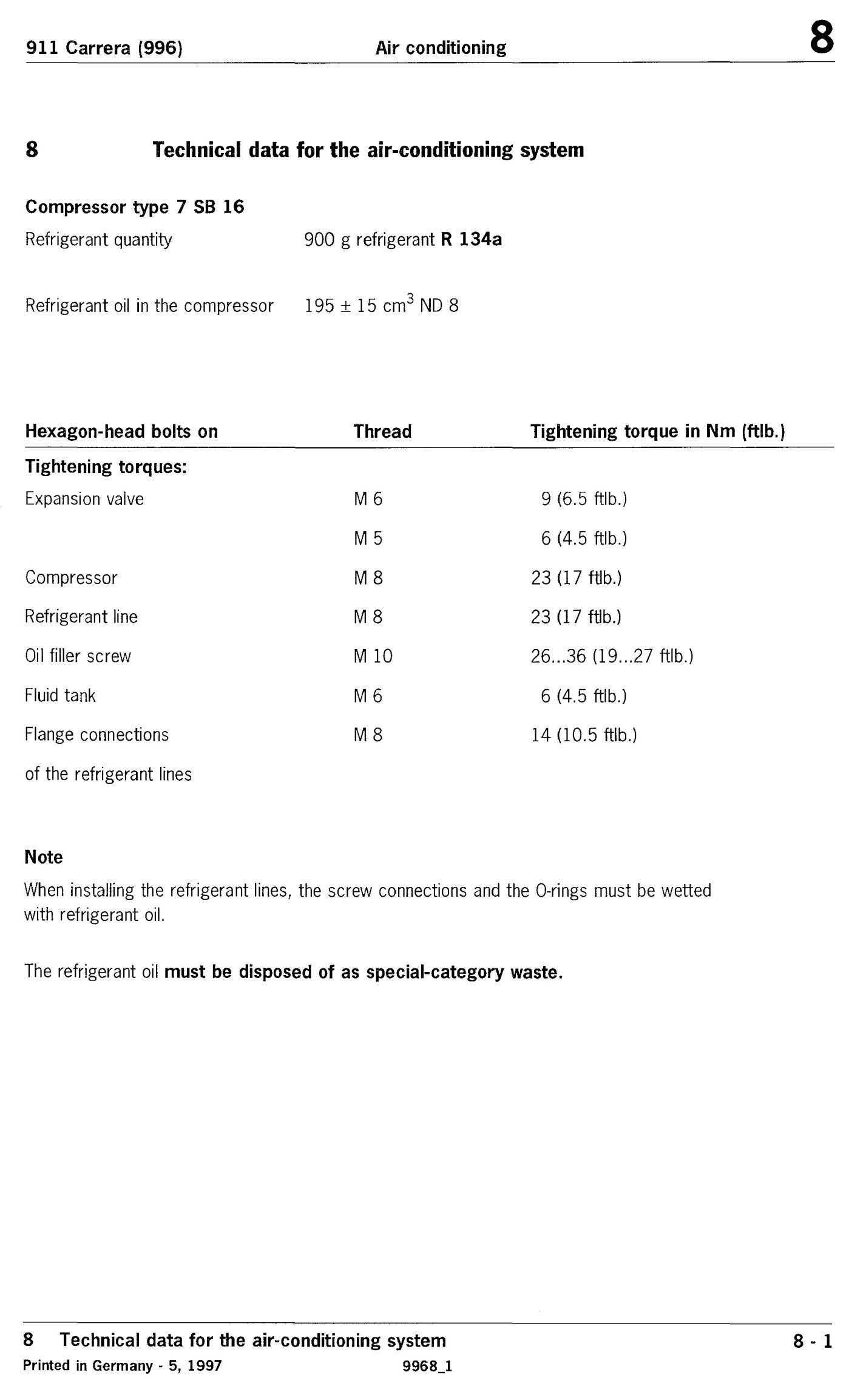

According to the workshop manual, all 996's use R134a refrigerant. You need 900g refrigerant, and 195cc ND8 lubricant. Take it to Kwik-Fit. They have the same gear as everyone else, and charge less than most.

Just to double-check for you, I looked back to my 1997 workshop manual, which clearly shows to use R134a refrigerant.
Edit: Here you go:
