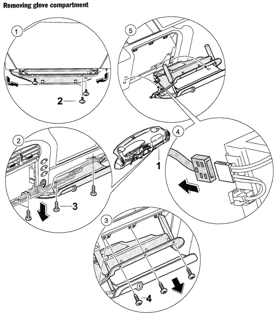

I am expecting a Dension Gateway 500 soon. I'm hoping to be able to hide the main unit away behind either the PCM or the glove box.
Before I start meddling, can anyone advise how the glove box is removed, and of there is likely to be space behind it for the Gateway.
David
Hopefully this is enough info on the glove box removal, but if you want the complete instructions, drop me an email.
How about putting it somewhere behind the lower half of the centre console. You might have enough space there. The side panels and carpet panels of the console unclip easily, and the CD holder (or storage bin) just pull out, so you can access it reasonably easily.
