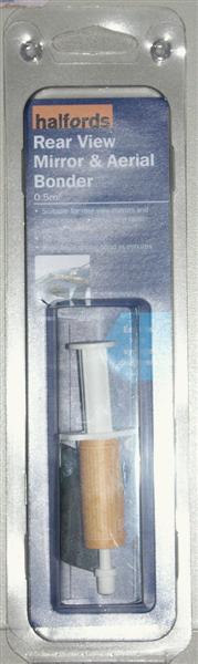

Dave,
Ok I'm convinced[;)] what was the name of the kit you used? I see you got it from Halfrauds[:mad:] (Must remember false beard, moustache & dark glasses before I go and purchase also park 993 out of sight[:D][:D])
Pete,
This is the one.
Dave
