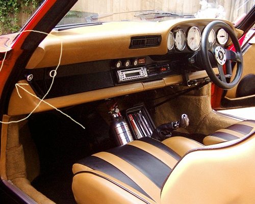

It's easy to overlook the full length of this seal as a contributor to wind noise, I think this is where most of the wind noise in my Targa comes from, I may replace it this year if I do I'll post the results.

Pete, I replaced mine about a year ago, when you do DONT do as I did....unless you know or are rather more astute then me (not difficult), it is easy to fit them without knowing where they should start and finish.
To explain, mine are in the wrong place....when you pick up a new one, feel around the whole seal until you find a strengthend piece...this fits in the 90 degree turn of the footwell corner of the door .... you can work the rest from there and cut it to length.
Southbound put me right on this, when discussing another matter!
I sealed mine in with a little silicon here and there..
I always do a dry run with seals nowadays Alan, it's amazing how much they can be stretched into place too if necessary though.
