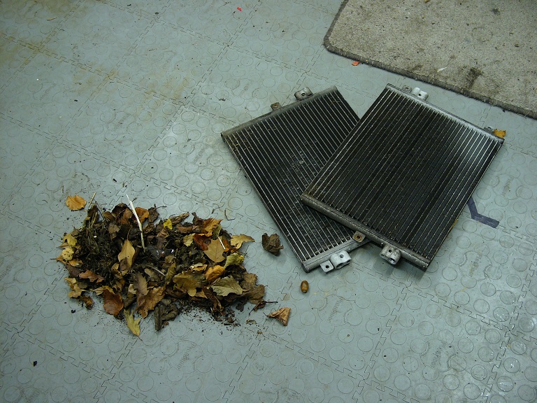

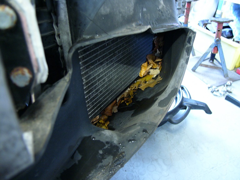

Definitely worth it. Lots of stories of condensers rotting out due to leaves and debris getting stuck round the bottom and soaking up moisture. To save money you could also makemyour own from mesh but they look best if fitted from behind which means removing the bumper.

The cost for replacing my rotten condensers from my local Porsche specialist was £720, fitting the grills cost £180. So I think it's a no brainer to fit the grills.

I guess it depends on how much risk you are going to take with your radiators / condensers. I fitted the grills to my 987 as there is plenty of room for rubble, small animals and other road debris to score a direct hit, as well as leaves and cigarette butts to get lodged. I also use the car a lot. The grills are easily cleaned so, as above, no contest.
