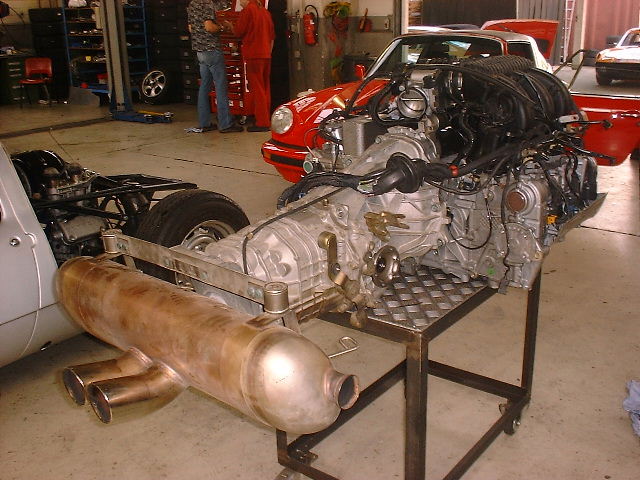

Anyone know if its possible to put the 3.8 litre 911GT3 engine in a Boxster/ Cayman. What's involved?
The Ruf conversion uses the 997 3.8 L engine and not the 3.6 GT3 unit. The GT3 unit will not fit as the gearbox is completely different as a result of the engine being derived from the earlier 993 model. As such it will only fit in a 911 where the gearbox and engine hangs out over the back axle. As to tuning for the 987/ boxster/ cayman , there are many options of engine swaps ranging from 3.4 , 3.6 (997 Carrera), and 3.8 in both standard and powerkit forms. The stock 3.2 can also be super/ turbo charged .
A 3.6L goes in a 2001 model S. But we had to use a lower engine mounting to accomodated the larger manifolds on the top of the 3.6L engine. The real fun and games start when you have to configure a different ECU to your cars electronics. Lot's and lot's of reprogramming and remapping, but it can be done...........eventually !!
