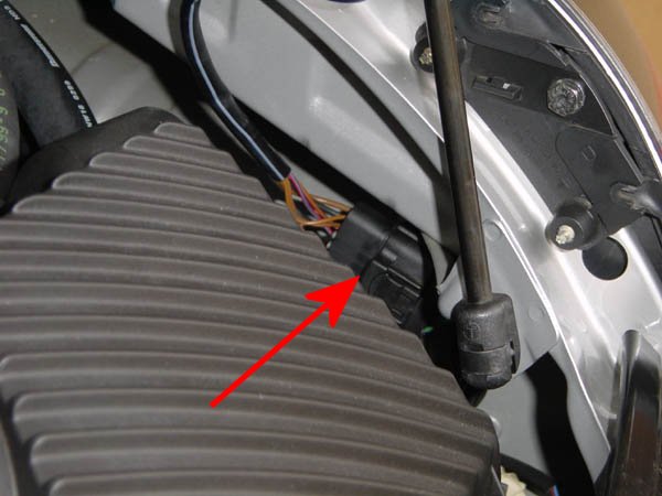

The connector for the electric spoiler is located at the right hand side of the engine compartment. It should be a simple matter of removing the loop-wire plug used with the aerokit, and plugging in the standard connector for the motorised spoiler.
