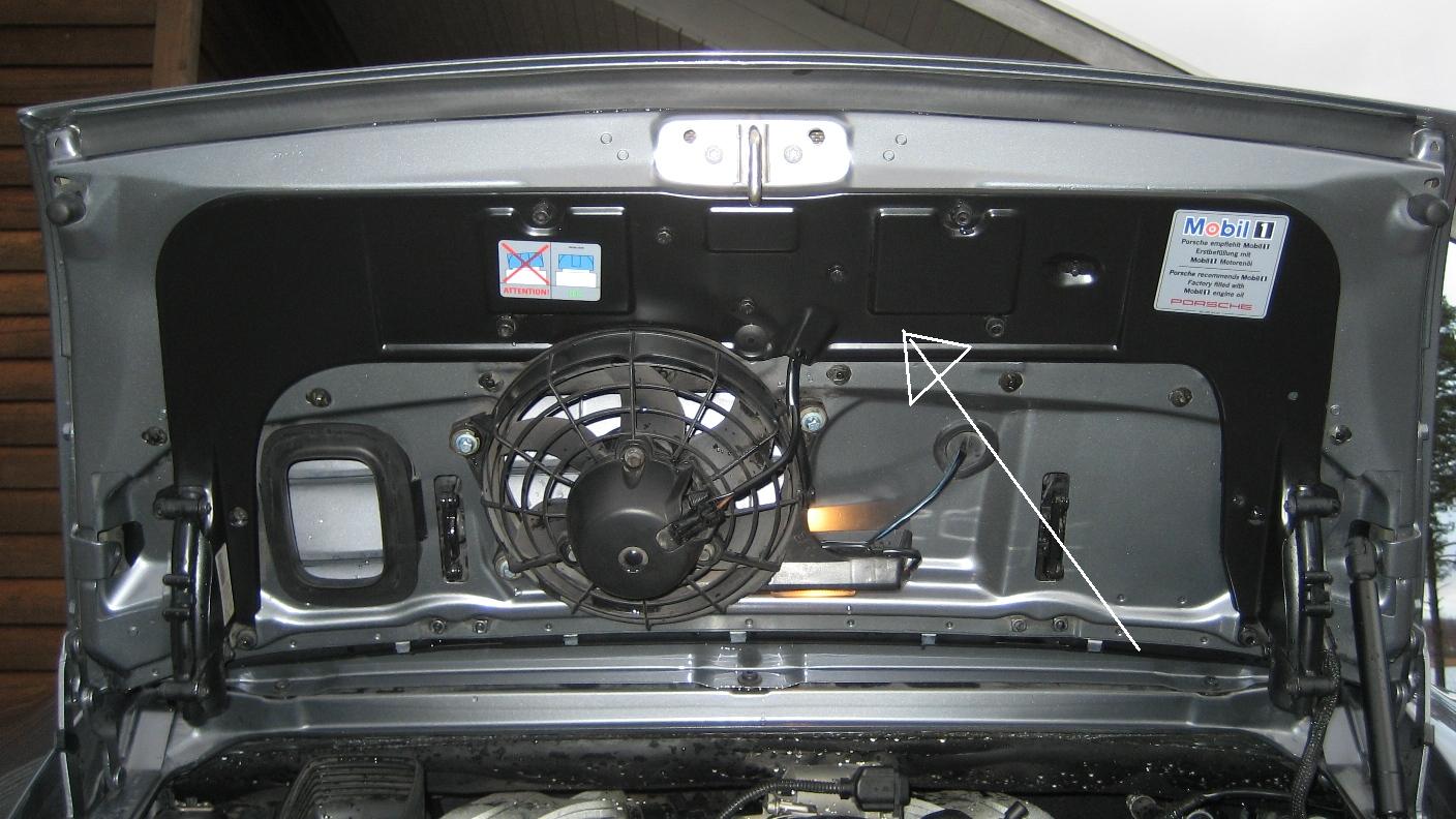

Hi
Do I need to install the black panel (see pic) on the GT3 lid from my current lid, or is it just for the rising wing??

Joafog, it's difficult to see from the pictures you posted, but it looks like all of the cut outs for fan, air inlet, etc, match up on both lids which leads me to think that the part you have is the decklid/spoiler of Carrera Aerokit and not GT3. In this case all of the ancillary items should bolt straight on to the new lid, so yes, you'll need to refit all to the new lid. This wouldn't be the case for the GT3 lid, the ancillary items are in slightly different positions and therefore the air box wouldn't line up and the lid wouldn't close.

The black panel in your picture includes the rams etc. for lifting the original spoiler and will not fit or be required. You will need to refit the engine fan assembly and associated wiring. The other part of the wiring harness will have to remain but neatly tied back and secured.
