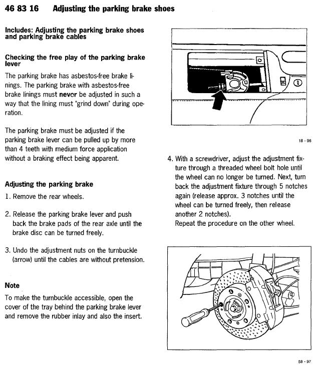

I need to tighten my handbrake cable. Can anyone tell me how to remove the interior trim without damaging it? Thanks
Just open the compartment in the centre console, lift out the rubber mat, and take out the base of the tray:
