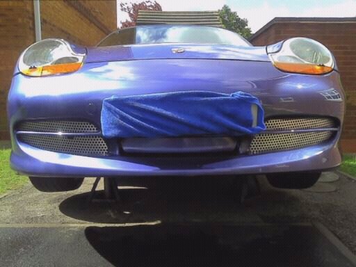

Front discs and pads fitted. Whilst the car was up on axle stands decided to investigate front pu grilles. Wasnt going to pay for the £180 porsche ones. Instead, took a trip to ....you know who....and bought some aluminium mesh. Will forward pictures later. Took me a fair while to mark out, cut and fit but its really looking good. All fixed with £2.49 clear silicone sealer.
