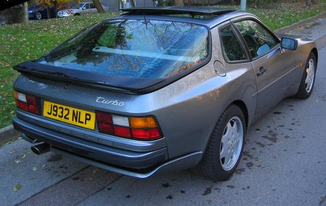

Hi all,
I just thought I would say a quick hello. I picked up my first Porsche last week and am as pleased as punch so far.
Its a late J plate Titanium 944 Turbo (SE?) with cream leather/carpets and black dash and is in pretty immaculate condition, bar the wheels which could do with a refurb. Its just awesome.
I will post you a few more piccies up so you can let me know your thoughts when I stop draining Esso of their fuel reserves.
Off to boost.
Cheers,
Charlie

Firstly thanks for the warm reception. Yip thats the one from Pistonheads. Just got back from a little spin down the A3. Cant seem to peel myself from the seat.
