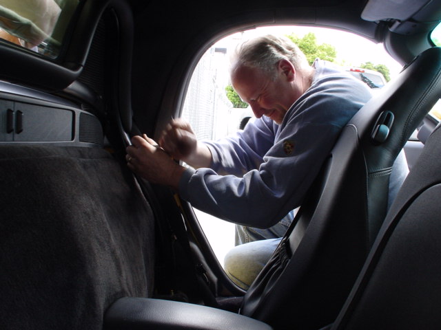

Remove the carpet trim inside the rear of the door aperture - one single screw near the base. you'll also need to slacken the anodised bolt at the top of the panel, inside the roll over bar.
The trim on the passenger side also carires the heated rear screen wiring, so take extra care removing this side. You can safely unplug the wiring whilst installing the spinlocks.
Lower roof, install spinlock sleeves - they are handed, with a notch on them - make sure you get them the right way around, so that the 'groove' on the cylinder of the barrel is at the rear of the car. Ensure you tap the spinlocks fully down.
Then raise the roof until approx 4" from the windscreen rail. You will be able to see the bolt hole for the spinlock , maybe have to pull the inner lining to one side first.
Make a small hole in the corner of a plastic sandwich bag, place the bolt and allen key in the bag with the bolt thread sticking out of the corner of the bag. Then wind the bag around the allen key, so that the bolt and allen key fit tightly together and you cannot lose the bolt into the dark recesses of the car.
Screw the bolt in approx 70%, then undo the bag and pull the bag over the bolt head - then continue to tighten the bolt til its fully in.
Refit the carpet trim panels, ensuring you connect the heated rear window wire.
