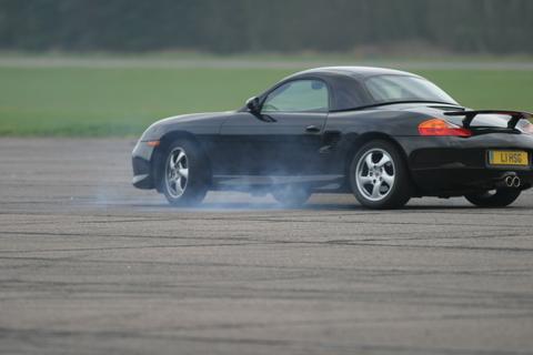

no, though i did do a track day with the hard top on which was a mistake as my car was noticable slower... or it could have been my whimpy driving[:-]

oh and for the record.no you wouldn't notice any diffrence in handling in normal road driving ... i was doing a track day.
