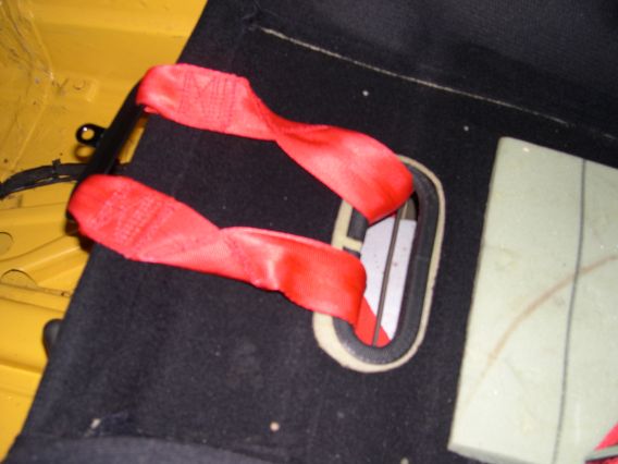

Hopefully we have a couple of photos, the first is looking down from the top of the seat with cushion removed showing the hole for the harness to come through.

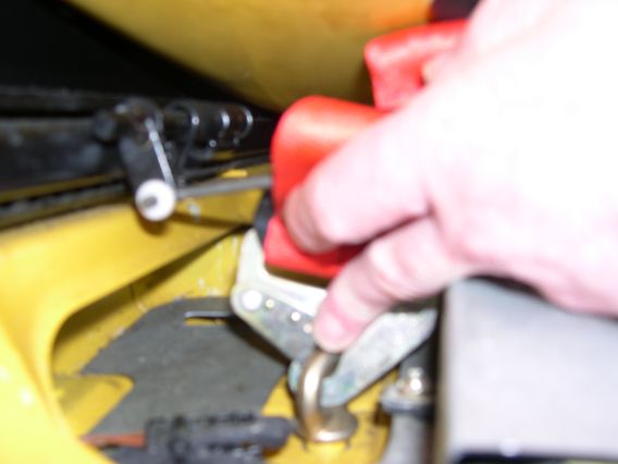

Second shot is underneath. showing the eyelets positioned either side of the ECU adjacent to the seat runners....
Sorry it is not such a great shot, sort of had to point and shoot under the seat!
If no one has put in crotch strap before, then you will have to drill out the plastic bung in the 2 holes. Once they are removed you just screw in the eyelets that usually come with your crotch strap.
Thanks ever so much, it is truly appreciated. Question, I can leave the ECU where it is? If so then it is simply drill/cut the seat, drill out the bungs and thread in the eyelets and go?
Hopefully you can see the position of my ECU under the seat, it seems fairly central with eyelets positioned either side...may make sense to remove or re position the ECU out of the way while drilling though!

The picture is of a 993 CS which comes with a 6 point harness from the factory (no seatbelts though) so the hole was precut. The trim looks like any edge trim you see on many cars,,,,if you went to a scrap yard and cut off a bit of door or boot/hatch seal trim this would do the job, just something to cover the potential sharp/hard edge of the aperture....any car trimmers would have a suitable edging and hidden under the cushion, I doubt anyone would notice if it was slightly different than factory supplied.
