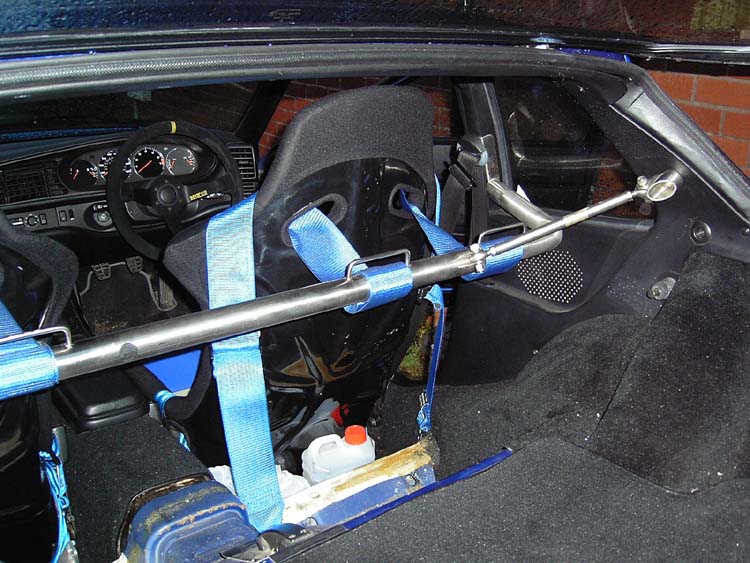

The BK bar is simply bolt in + out, theres no damaging of trim ..
See pics.
Another pic.
The shoulder belts are connected to the bar . but the lap + crotch belts are fastened to the floor.
These pics were taken in my "old" 944S2. But the 968 is exactly the same.

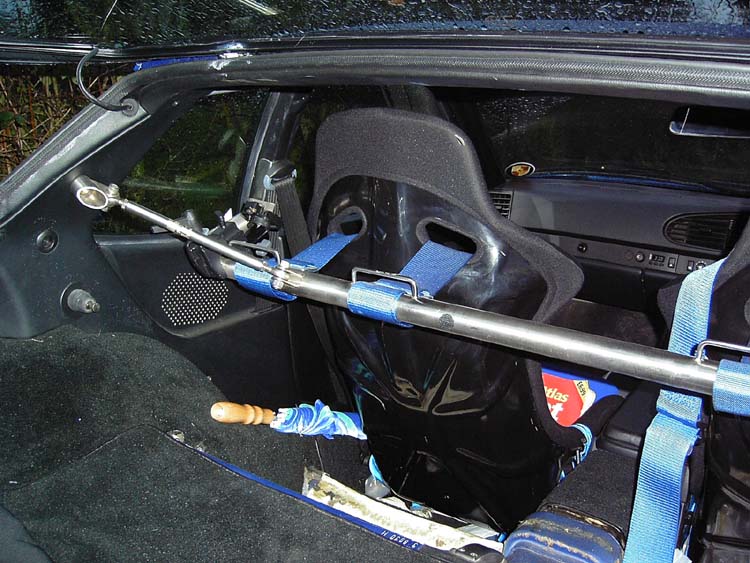

Another pic.

That is a harness GUIDE bar [see here] designed to create the correct angle for the shoulder belts behind the seat. It is not a harness bar.
The harnesses pass over the bar and must bolt to the mounts in the floor [&o]

I NEVER said it was a half cage...."roll bar" were my words...
Paul. Yes you are correct it is a harness guide bar , i didnt say it was anything else....The fact that I havnt fitted the harnesses to the bulkhead mounts is totaly up to me..
Have you used one of these bars.???
Trust me they are very solid bits of kit...
Ive had this one for a good 4 years or so + have had the belts fitted like this all the time. There is NO flex or give in the bar... OK so i maybee havnt fitted the belts in full acordance with item description, but there isnt any instructions when you get the bar.. So i guess you can fit them however you want...
I certainly feel safe with it...
Sorry, I wrote without proper consideration and dont mean to offend or criticise.
In my view the bar is fine as a guide bar but what you have to imagine is two normal weight adults in a frontal will weigh (guessing based upon air bags firing at around 10G) the equivalent of at least 0.6 to 0.7 tonnes EACH very momentarily or probably more in a heavy shunt.
Ergo despite how it looks you will then realise the centre will move forward or fail as the 1.2 - 1.4 tonnes exerted momentarily/snatch loaded (albeit spread a bit) will definitely bend it. Stainless isnt as tensile as steel so it is probable it will fracture too.
As Dave has re-iterated I don't think he has said that this replaces a cage. I had one these fitted to my 968 and I have to say that it is better made and a better fit than a Safety Devices half cage I have had previously fitted on a 968. When Peter had these made they used his car for the initial template and the fit of these is utter precision, using factory mounting points. They are a great way of securing your harnesses and although not a roll cage would certainly give you protection in the event of a crash.
I spoke to the UK distributor yesterday and he says it is a guide bar and Harnesses should be mounted to the normal car points not the bar. It creates a problem in the CS as the GF shelf that replaces the rear seats would be in the way for the harnesses to come up to the bar and equally if the bar is not strong enough and therefore possibly give in an accident then the harnesses will be useless as they would allow substantial forward travel, time to consider a cage maybe :hmm:
