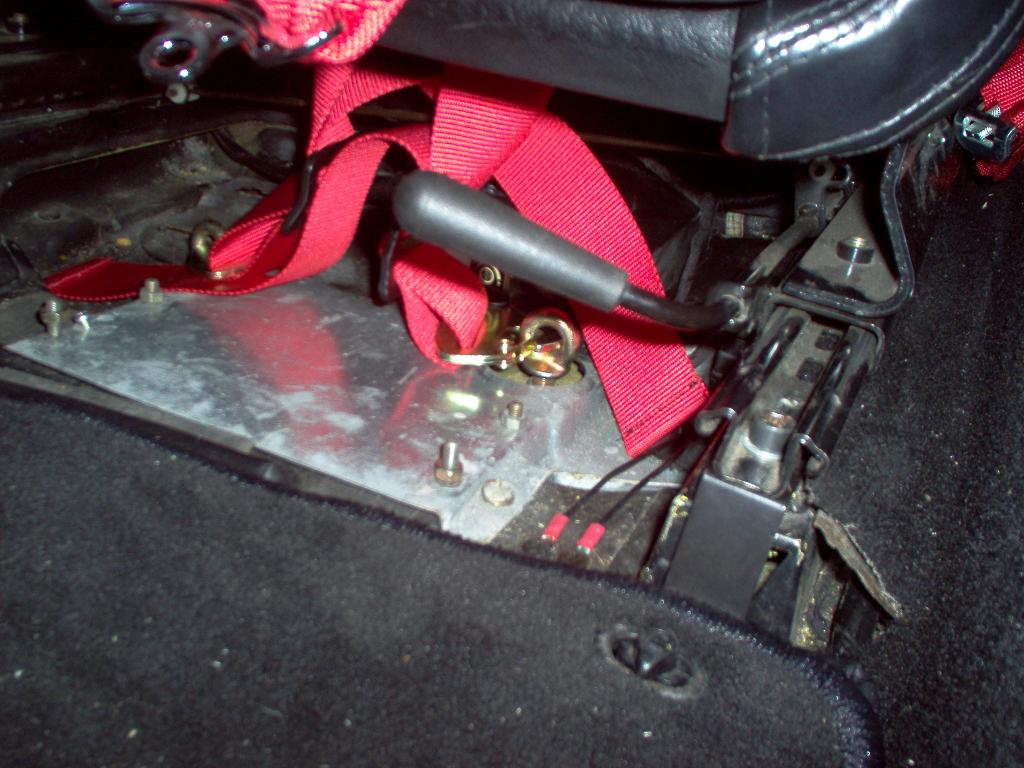

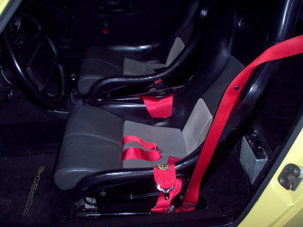

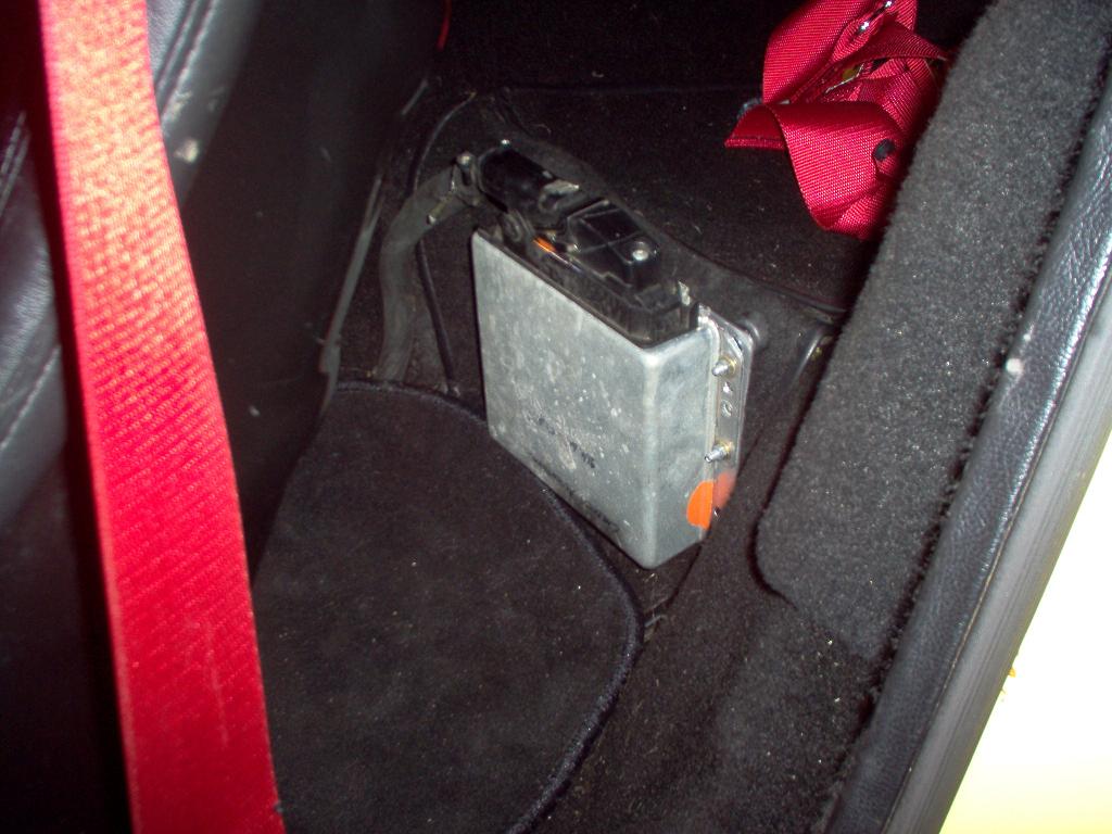

i have sabelt six point harness installed to the locating points put there by the nice people at the factory via eyelets screwed into the points. To acess the crotch strap holes you have to remove the dme and refit it to the rear seat upright a la cup car placing. All the fixings for this should be already there. A mod plate for fixing the dme is (or was) availiable from Porsche though it's very straight forward to make one yourself.
